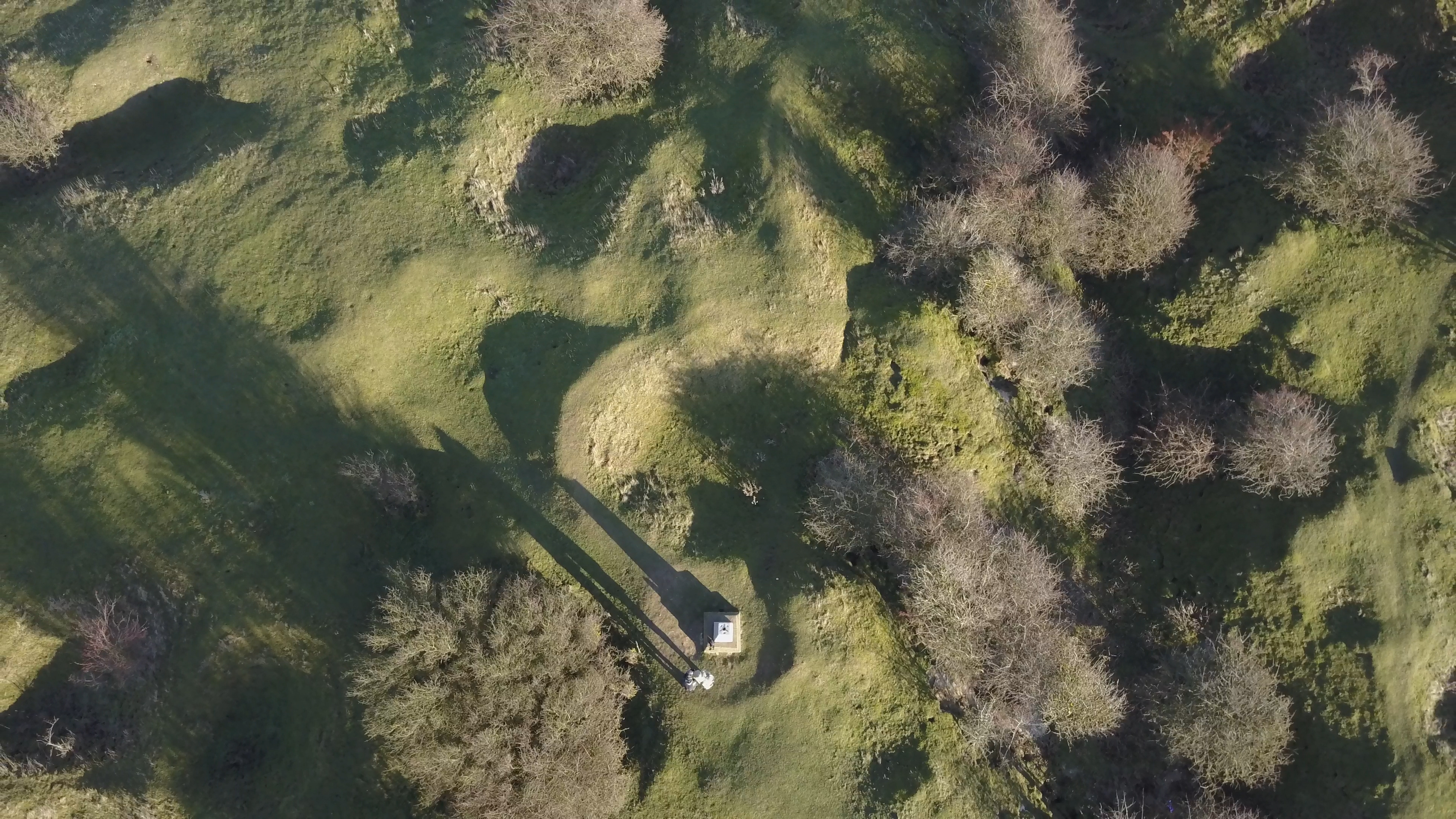

Hello,
The following grab is an ungraded export from Premiere Pro.
Can I assume this blockiness in the shadows is as good as we are gonna get from this little camera?
This was 4k. D-Cinelike (-2,-1,-1)
Ive read shooting at 2.7k might be the best way forward but any other tips much appreciated.
This footage is upgradable.
Any colour correction magnifies the issue.
for the untrained eye, can you tell us what we are supposed to be looking for? What blockiness in the shadows?
If you look in the shadows, there are square artefacts - ok maybe i am being a little precious, but actually an iPhone camera is better than this.
OK, so I zoomed in the shadows and I'm still not sure what I'm looking for.
Again, I have an untrained eye and would be nice to learn these things

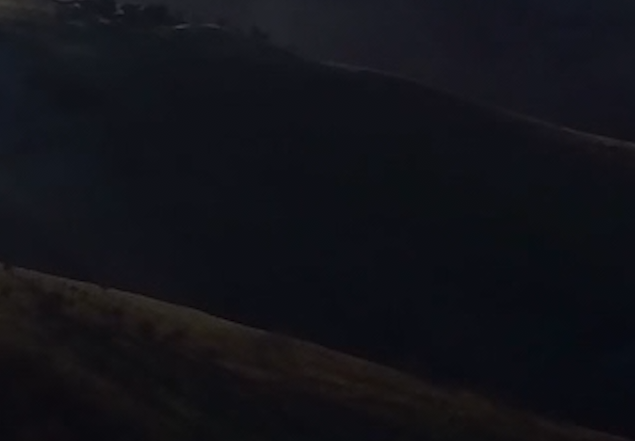

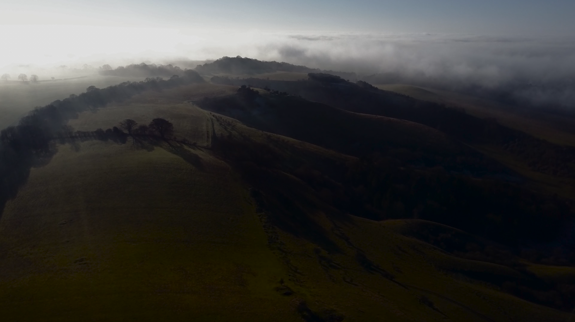

Its basically an unwanted noise - or lack of resolution.
Here's two shots from the same flight.
This time i colour corrected them a little - it highlights the problem better.
There's the full frame...
Then the zoomed in same - representing 100% on my monitor.
In this you can see odd blocks that are basically bad compression (i think)
And the problem is that these blocks jump around every frame.
I think i am doing a really bad explanation of why things are happening, but I hope at least you can see what the problem is.
I know I cant expect the earth on this little drone, but I expected more.
I also suspect that there are tips & tricks out there to get the most out of this little camera, and am on a journey to find out what these are!
I took the color out and brighten the image since I pretty much couldnt see anything on your shot (shows how untrained my eye is)
And this is what i see, indeed some blocks in the shadows.
Is this what I'm supposed to be looking for?
