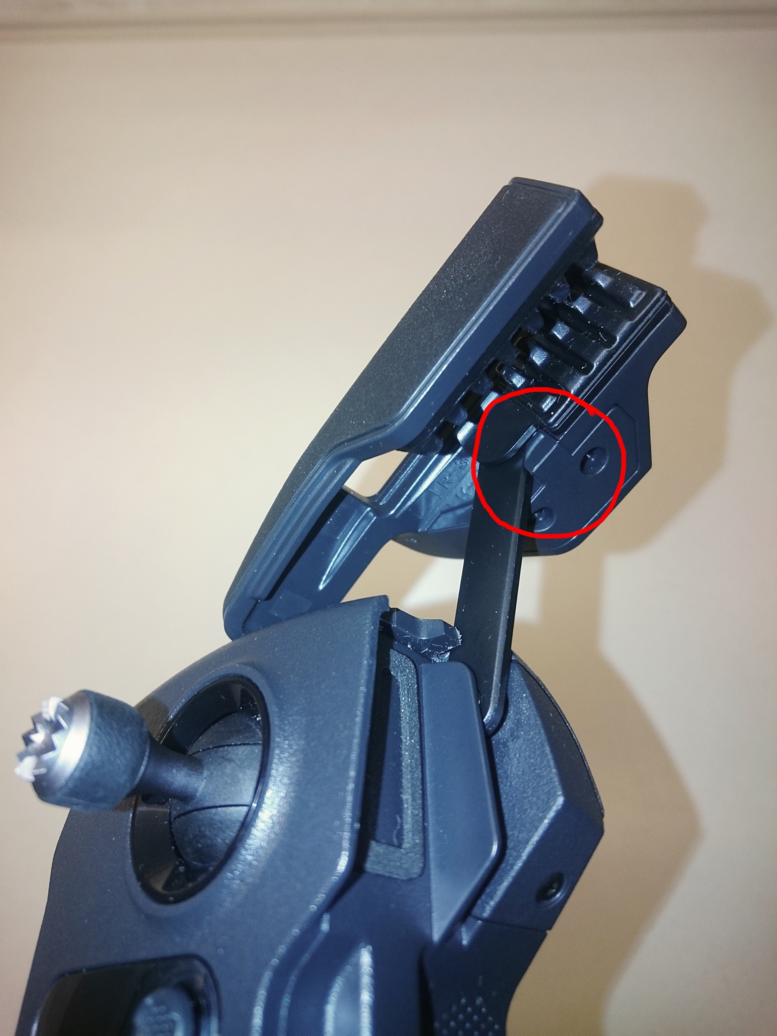

after thorough analysis I came to the conclusion, that in order for the tablet to fit, arms had to be able to open to their maximum, to the horizontal position
and it could be easily done by cutting out small piece of plastic on both sides of the remote

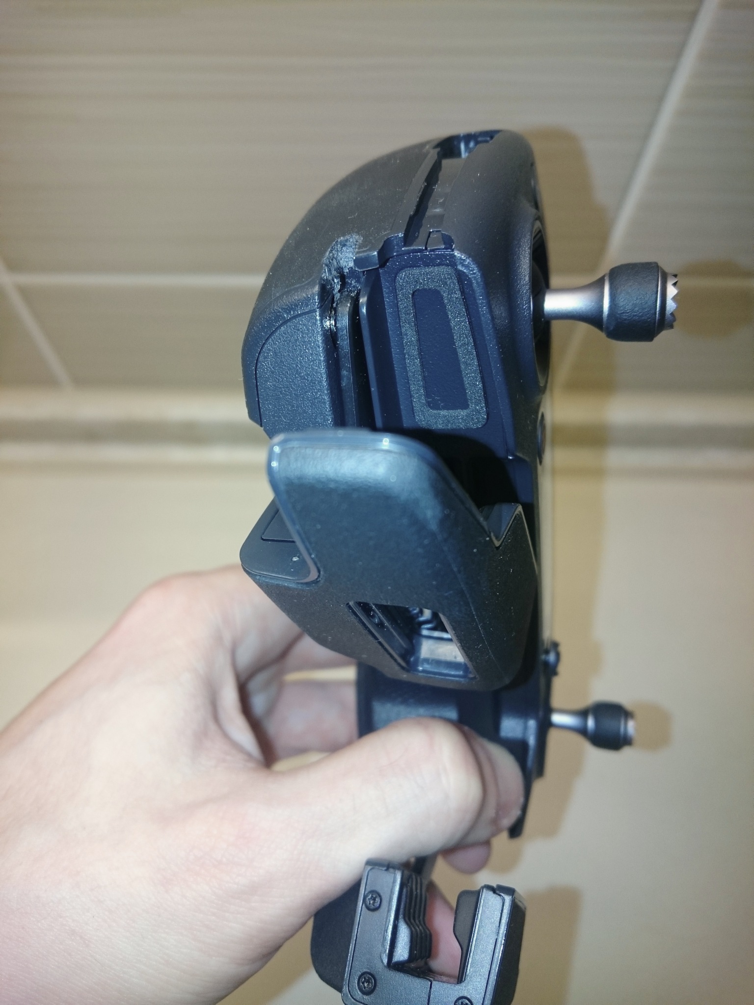

the cut looks like this:

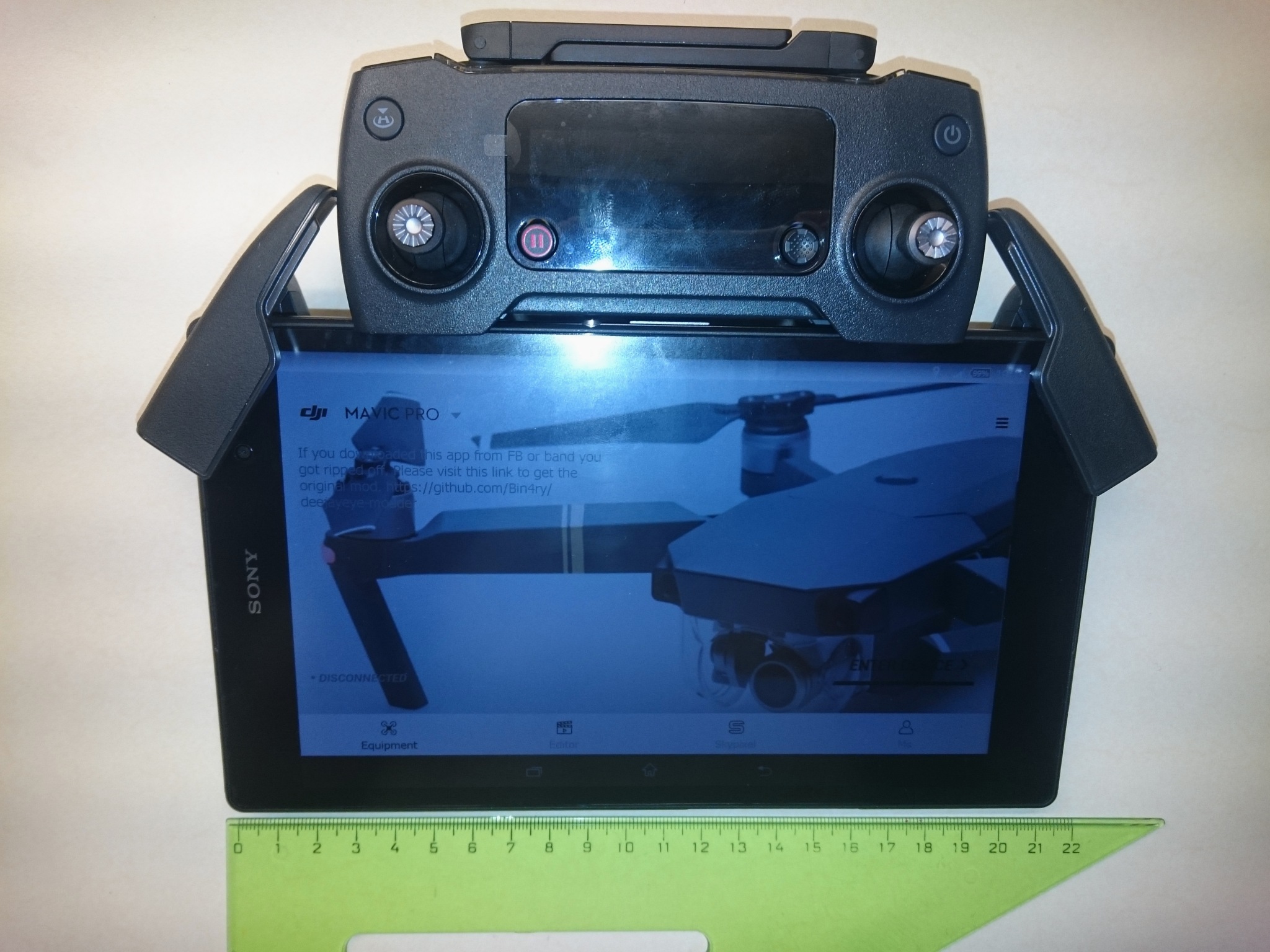

the result is very good, remote controller can now hold 22 cm long tablets:
bonus:
if you look carefully at the handles, on both of them there is triangle-shaped plastic part, that stands in the way for handles to fully open
so if you unscrew those two torx screws, remove that whole plastic part and screw the screws back, you'll get maybe another centimeter
