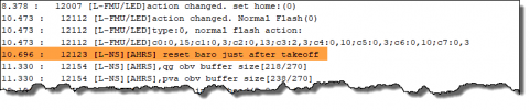

That's correct ... this as the HP height are only reset if the barometric sensor is reset, & that only happens at a take off.
This is easily seen in the mobile device DAT log just after take off ... here an example from one of my own logs.
