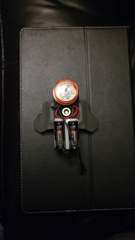

I used one to hold a 3 strobe light and battery. I cut a small piece of thin kydex 1' X 3" and drilled a hole for the stud. I attach the kydex with a 1/4-20 nut. Then I used Velcro to attach the light and batteries to it. The way I have it positioned it covers the button on the battery. I did not see this as a problem as it pops on and off easily. I'll post a picture of it later.
Reactions: Mighty J Fury
Here are the pictures

TheAlien: I think those posts you saw about interfering with GPS were referring to the metal object they placed on top that caused the interference, not from the 1/4-20 adapter. Other than the bolt, it's all plastic.
Right you are. I purchased that mount and found no interference with the mount itself.
So did I, Mike, and while I haven't used it to mount anything, I did make sure that it didn't reduce GPS signal reception. Still haven't installed the strobes but plan to Real Soon Now. :)
