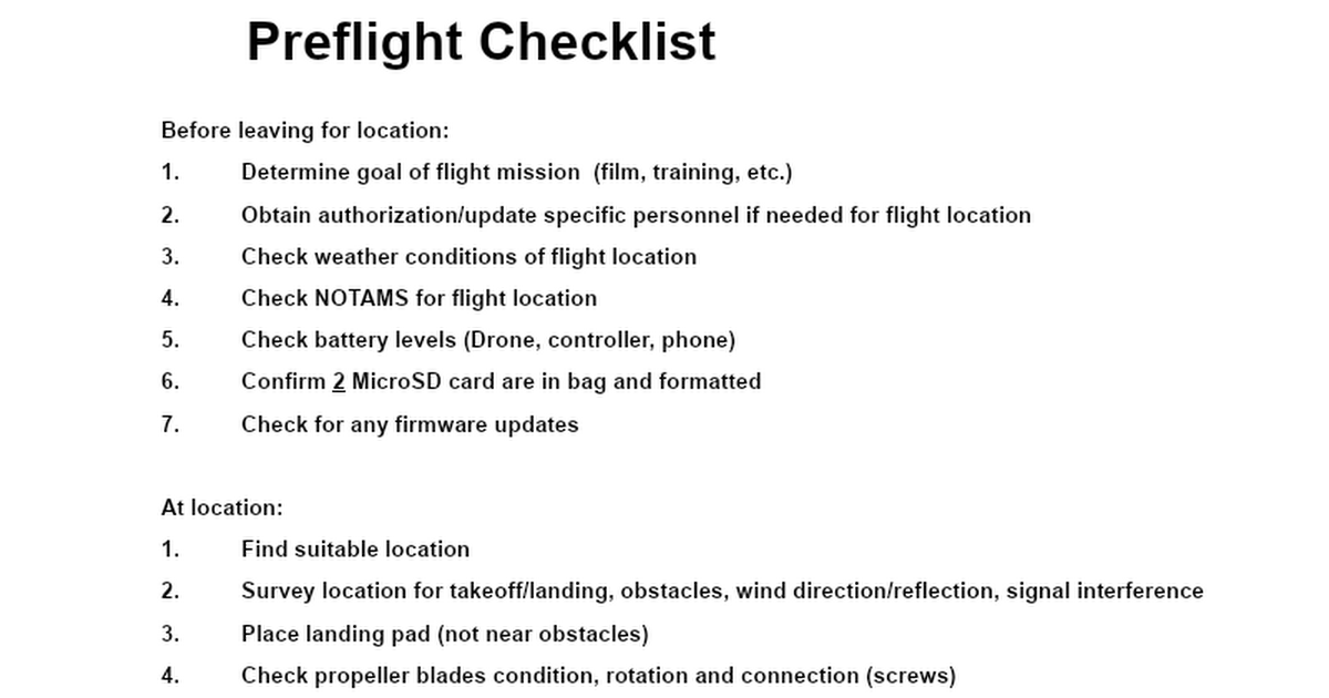

Interesting! Re 'pre-flight checklist', has anyone got one to share?
