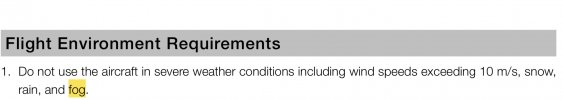

Why do people keep flying their Mini’s in the fog? It’s in the manual - don’t fly in fog. Then when they inevitably have problems, or lose their drones they blame the product. Read the manual, then read it again.
From the manual;
