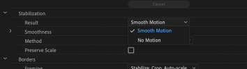

I told you at the time Dale, import them into premiere pro, and change your stabilisation method from ‘smooth motion’ to ‘no motion’
Hi Showflow,
- Import your images as RAW into photoshop or lightroom to edit the images. (Ie, increase contract, saturation etc)
- export your files as JPEG’s
- don’t use the image align in, photoshop, just edit the pics and export as jpegs
- import these JPEG files into either premiere pro or da Vinci and stabilise in there
- I use premiere pro so I cannot comment on da Vinci, but in PP, use ‘warp stabiliser’ and change the stabilisation mode from ‘smooth motion’ to ‘no motion’ (given your timelapse is static)
- this should smooth the motion, without the buildings wobbling

Yep same thing as in Resolve.

Dkhune:
Here are the two screen shots. Please tell me what to click on, step by step please. Do I draw warp stabilization on to the clip, then, where do I click in the next window? (sorry I duplicated the 2nd window-ignore it).
Dkhune:
Oops- I just found it! Can't wait to try it out and I'll let you know.

Warp stabilizer or Resolve perspective stabilization will do the trick just as long as the camera is pointed in the general direction. I’ve had clips where the camera literally pans to the left or right and it was able to correct it so everything is perfectly stationary. You’ll pick up a bit of a crop but you have to crop to get it to a video aspect ratio anyway.
