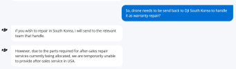

I did reach out to DJI support and they claim they are unable to provide after-sale services in the USA so looks like I will have to send the drone back to my Korean seller and they would have to initiate service with DJI South Korea:
Don't rely on a chat bot. I would call them on the phone in Los Angeles, and explain your predicament to a live person. I was told by a senior manager that they would repair any Mavic 4 Pro at your expense. Ask for a Supervisor.
