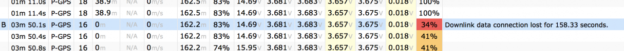

Then I grabbed the remote and Litchi it said .... disconnected .... I was too baffled too check what he display of the remote said. After some fiddling I restarted Litchi and I saw some youngsters picking up my Mavic. I went towards them had a laugh and went inside to check the files and the videos. After a flight of 1 minute no more data and no more video. After 2 minutes 'downlink data connection lost for 158 seconds.
I cannot imagine what I did wrong except laying down the remote in the grass. I exported the flight file in Assistant, but I don't know how to read it.
Help me understand what caused this.Schermafbeelding 2022-03-22 om 19.19.32.png

Here are the files. I'm really curious if there is any clue to what happened. I forgot to tell that the Mavic only has minor damage. The CSC file refuses to upload. Is there any trick ??
  • DJIFlightRecord_2022-03-22_[18-46-06].txt
It's enough with the TXT log you've shared ...
Unfortunately we would have needed another log that isn't created as you used Litchi ... the TXT (& Litchi CSV) contain all telemetry ... i.e. we can see all stick commands, speeds, heights & craft movements in all axis ... but we can't see any motor data or any raw sensor data, that info is stored in the DAT log. 2 DAT logs are created if you use a DJI app, one in the craft itself (encrypted so we can't read it) & one in your mobile device (but when using Litchi this one isn't created).
So all we have is the telemetry ...
Here you have some relevant data out from your attached TXT log drawn out in a chart, the chart is zoomed in on the period between 57sec into the flight where you release the sticks & start to hover the M2P ... to the end of the log.
If you click on the chart you make it bigger ... the graphs are explained in the legend under the chart, the stick commands is dashed graphs, values in the legend is from where the chart marker is placed, in the end at 75sec.
As seen, nothing indicate a up coming disaster ... the M2P pitch up to brake when you release the sticks & the speed goes to 0mph. There in the end where the chart marker is placed at 75sec, your sticks are neutral (value 1024), height is stable & roll pitch and yaw doesn't show any abrupt or abnormal values ... then the log ends.
If looking at the battery data it looks like below ... nothing abnormal there either, also the log indicate that the motors are up & running.
As we know that the TXT log is recording between motors on to off when the M2P is connected with the RC+app ... it leaves us with 2 reasons for a log recording termination.
1. You lost the RC+app to M2P connection ... but not likely as that wouldn't make your M2P crash into the ground.
2. The motors stops ... will happen if it's a sudden power loss. This is likely ... as we have earlier seen several batteries coming lose from M2P's due to some swelling during flight.
So with what we have nothing definitive can be said ... but it's very likely that this incident was due to a sudden power loss ... so the disconnect you first reacted on was actually your M2P shutting down & start to free fall.

I've uploaded the csv-file to Phantomhelp with gives about the same parameters as Airdata. In another attempt I imported the same csv-file in Excel and to me surprise many more data are available.
This is a screenshot of only the relevant fields at the moment were there is an inexplainable gap in time from 18h47 till 18h50.
