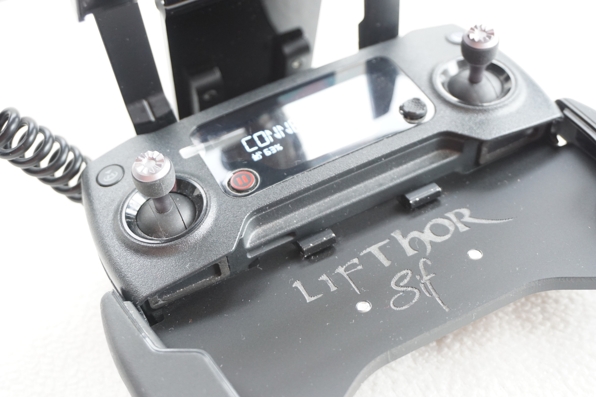

Can you please send the link to get this cable? I need one of those.. Thanks
It is the Adams Elements RC cable for the Mavic Air. It used to be available on Amazon and the DJI store. You can search for it (on my phone now and can't do a proper search) It comes in mini USB, USB C, and iPhone variations so pick the one that fits your phone. Very sturdy cable.
These are brilliant, spiral cable and right angle to device provides cable out of the way too.
A search for connecthor also shows them on Amazon.
Thanks..
