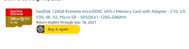

I got the fly more combo, as well as an external SD card (the sandisk one which is supposed to be the good one)

Have you tried using the 8gb internal storage instead of the the MicroSD card to test if the card is the problem?
Can you post a picture of the MicroSD Card?
Yes I did do that today. Got two panormas, before I ended up with same issues all as above.
that pink screen is also with SD card unplugged.
This is the SD card.
It's not the card.
I have the same one with zero problems since 2017.
You might look into exchanging the MA2 if it's under warranty because it doesn't seem right.

Before you return it, if you have another SD card, I'd try it.
I use the same SD card in my M2 Pro, but with anything, you could have a bad one.
Have you tried to format it?
If it formats in the drone, try formatting it in your computer, then install it in the drone.
If you've already tried formatting, I'd try another SD card, just to rule it out completely.
In fact, when I returned my M2 Pro for issues, they wanted the SD card, for testing.
