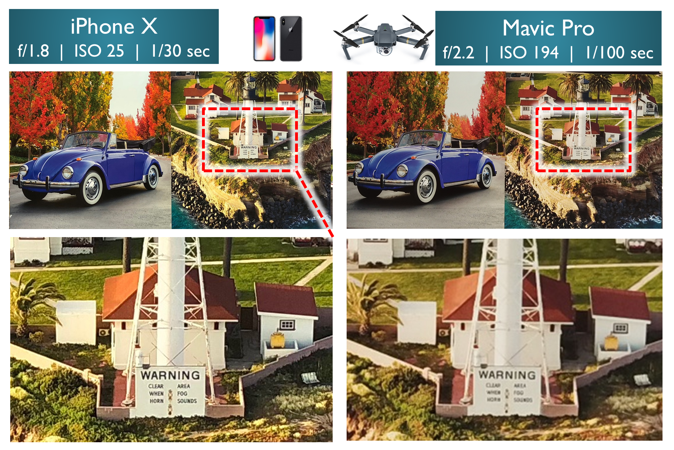

One other question is what has a better camera, an iPhone or the Mavic? At a half inch it's far, far larger than the iPhone.
Keep in mind the glass and the software play a part too. Here is the answer to that question...
Those are for stills, right? Video might be closer.
The Mavic Pro uses a Sony IMX377 1/2.3 sensor and the iPhoneX uses an (I believe Sony CMOS) 1/2.0 sensor, so the sensor of the iPhone is bigger. But size isn't everything. The iPhone also uses a sophisticated processor that is specifically for the camera. I understand that the new Samsung sensor is impressive too.
