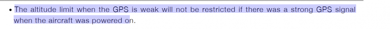

5 - Yes, per manual if it has no GPS, but does have downward sensors, the height is limited to 16 feet. The other option in your case, instead of covering sensors is to power it on outside, get a GPS signal, and then walk it inside. It's supposed to not limit height if you had good GPS signal at one point. That should work, but I've never personally tried it.

I don't think powering on in GPS area and then moving indoors is a good idea. Compass errors have been known to result.
Note that without GPS, the only thing remaining to help with lateral stabilization is the VPS sensors (downward cameras). VPS is limited to about 15ft from ground, hence the limitation without GPS. Without GPS and VPS, you're effectively in ATTI, subject to drifts including wind. It's not too easy flying in ATTI.

Timing of the indoor discussion is ironic, as the notes on the new firmware for today say they've increased the no GPS height limit to 30 meters an enhanced the vision sensors, so this should all go away with the new firmware.
With that said, For many reasons, losing GPS is different than never having GPS, as it would be bad to add restrictions mid-flight as you might not be able to get it back home...

Yes, the limit is not going to be imposed in the middle of the flight.
When I first posted the work around of starting with a strong GPS signal outdoors before moving indoors, I wasn't just guessing or making it up. The information is in the manual. If you start with a good GPS signal, there will be no limits, no matter what happens afterwards. Here's the manual wording:
Regarding my thinking what's the different between no / lost GPS... I didn't think the Mavic would descend or change course if GPS was lost mid-flight. I was just thinking if I took it outside, locked GPS and then carried it inside and tried to take off that it likely wouldn't work just the same. (As I would not have a GPS lock at the time I took off.)
I suppose if I took off outside and flew through the doors I might have been able to achieve higher altitude once inside, but again, this wasn't even something that crossed my mind at the time.
