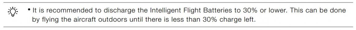

Hello, refer to the picture straight from the MA2 manual. Can someone explain to me what does this means? Is it before charging, for storage? Little confuse. Thanks.
Thank you Repaid1, so I take it that means when traveling or shipping item but when not in used you can leave it at 60% or so.
Yeah it's a stability thing for battery chemistry. Some airlines / shippers required it some don't..I always leave 2 lights solid, one flashing in "home" mode :)
