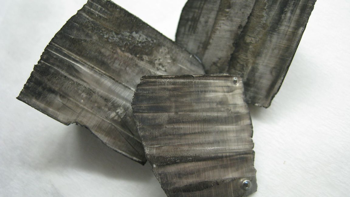

Scientists pinpoint cause of harmful dendrites and whiskers in lithium batteries
