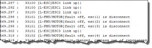

Same incident as the earlier one... all motor side data freezes at 511,773sec with the messages in the DAT event log about disconnected ESC's. At 569,287 the ESC links are reestablished for a unknown reason.
DAT events at the time when the ESC's disconnect:
And when they reconnect:
So no more to go on this time either ... perhaps time to get it in for a repair before something more catastrophic happens.
