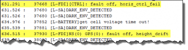

If we then check the DAT log event stream we see this when it all starts ...
And when all goes back to normal ... "fault off" as nothing have happened!
