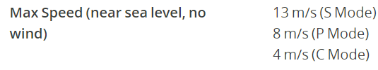

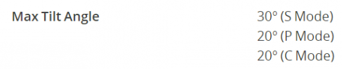

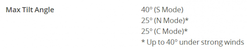

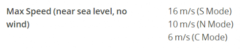

From memory greater angles of tilt, 40/25/25 vs 30/20/20 (in the specifications of the corresponding manuals). Drones move horizontally by tilting thereby generating horizontal thrust, the greater the tilt the greater that horizontal thrust BUT NOTE the less the vertical thrust (lift), so motor speeds likely increase as the angel of tilt increases to compensate for the reduced lift.
If we instead talk about the difference to make headway into the wind first ... there it's only about the speed, which is closely linked to the max allowed tilt angle.
Comparing the 2 ...
DJI Mavic Mini:
DJI Mini 2:
It's pretty obvious that the Mini 2 can penetrate a stronger wind than the Mavic Mini ... all depending on the max speed. Furthermore, if you loose connection & are depending on RTH the Mini 2 is far, far better, this as the speed used in RTH is the same as in N mode ... the Mavic Mini will be stopped by a headwind on 8m/s, but a Mini 2 will actually be able to produce a tilt angle on 40 degrees (same as Sport mode, see the *) which means a speed on 16m/s before it is stopped by a equal fast headwind.
The somewhat unexplained "Wind resistance" that DJI have in the specs doesn't fit the max speeds though ... it's suspected that those figures might be valid in a hover ... how a strong wind the drone can take & still keep position.
