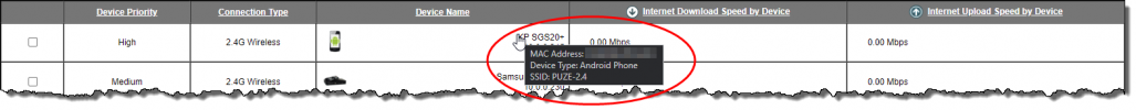

You don't need to do that permanently ... just turn access control off, connect your RC & then go into you router & look up the "connected devices" section, you should there be able to see the MAC address & can note it down.
Then set your RC up with the Access control on now when you know it's MAC address.
This is how a connected device looks in my router ... I mouse over it & the MAC address is shown.
