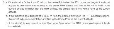

Testing the "accuracy" I take off and hover above the bright orange landing pad for a short time then take off and go maybe 100 eet away and 50 feet up, I hit the RTH button and it lands exactly where it is. Doesn't even try to return to the landing pad. Admittedly the landing pad is on my patio and there is some "stuff" within 5-10 feet of it but why is there even no attempt to land on the pad and just go straight down into the grass and land nowhere near the pad (10-15 feet away).

Your to close fly out couple hundred feet then try, it will work. Your trying with it to close to you I think it has to be 75feet or more away from home point
I’m afraid of I did that it would land where I do not want it to. ? Do I have to start the RTH from that distance or just go that far and then it no longer matters.

Check the manual again. The Return to Home will either 1) Ascend to the RTH altitude and go to the home point, 2)go directly to the homepoint at current altitude or 3)Land where it is. Which option depends upon how far you are from the homepoint. Sounds like you are within 5 meters.
