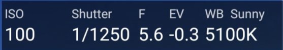

The reason the pix are overexposed is that you've got the exposure compensation set to +2.0.
That's adjusting the exposure settings to 2 stops more than the camera's metering thinks would be correct.
Look for the line of camera data on your screen and notice under EV, it's showing +2.0.
You need to dial that back to 0 or even -0.3 and your exposure will be fine.
