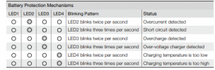

Do any of these error codes describe what you're seeing (Mini 3P manual pg 35)?
2 lights, blinking 3x... short circuit, over-voltage, or too hot?
