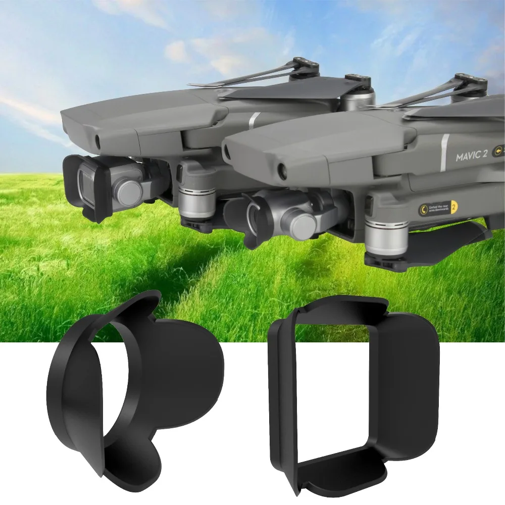

I'm surprised no-one has come up with a solution like this. Use them with my mav 2's and they work well.

Curious why they're not full coverage like typical lens hoods... probably because the corners don't matter optically, so save cost with less material?
It's because if you didn’t have the corners cut out you would actually see the lens hood in the image at wide angles.
But a lens hood won't help except to block the sun from hitting your lens when it's just outside teh field of view.
If you can see the sun in the image, no lens hood will help at all.
DJI wideangle lenses are already recessed into the camera housing and this probably gives all the protection needed anyway.

It's a petal style lens hood. Usually, FOV is wider side to side and the side lobes are smaller to not be in view. The corners of rectangular sensor will have the largest extent and hence the widest angle. In a DSLR/ILC you can usually rotate it 90 degrees anyway.
For a drone, the limiting factor is the end stop cal when turned on; the cam goes through a full range of motion and you don't want to bump the body. I imagine you could power up first and then mount the hood but I dislike touching the gimbal when the positioning motors are powered up.
When winter comes, I plan to either design one or find a design to 3d print to experiment with. There is not a lot of room left by the gimbal cal so I am skeptical it would really fit.

I had something similar for my Mini and found it to be pretty useless to stop flares -- they're too short. If you look at this photo, sunlight can get in from the same angle as this photo view, which would be well outside the camera's angle of view.
