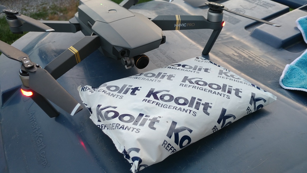

I'd be more concerned about leaving a lipo in my car during day more than anything. Last summer if I had to absolutely leave charged batts in my car I put them in a small cooler with one of those reusable ice packs wrapped in a towel. It cools off the cooler just enough.

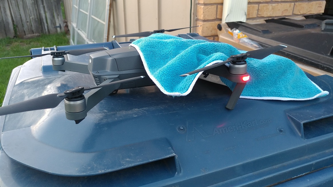

I didn't get any warnings, but with the mavic, controller and Mini 4 all were hot, so I just gave it a little cool down time. I'm going to pack a hand towel in my cooler when I go fly and after I'm done just lay it over the bird and let it pull in the cool air for a bit. Then pack it away in the case to go home.

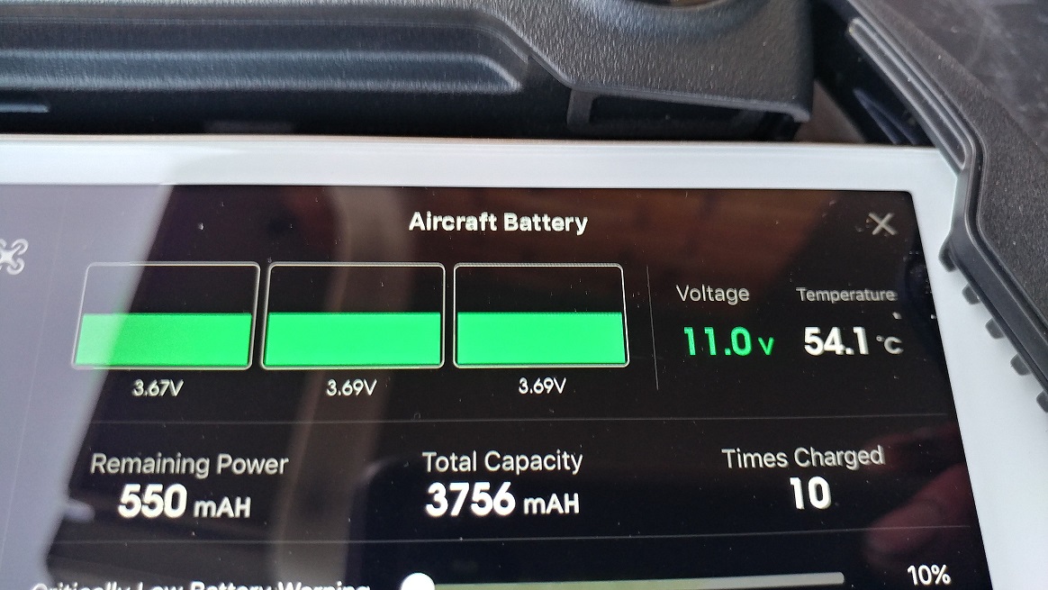

So let's be realistic with this situation as far as DJI is concerned. If flying in hot weather was a major issue, the Mavic would have red flags Incorporated in the software. Such as the battery. I believe there is an area in the battery section that currently displays the batteries temp. However, that is in a section where you must dig for the info and not where it displays live like it should be. As far as the battery data goes, DJI would rather be secretive with it so they can better manipulate its data.
