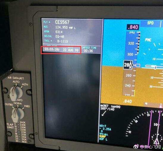

I gathered up all my GPS receivers before the rollover date. To get an idea of when they were last updated, as each of the units booted up, I noted the dates that quickly flashed on-screen. I checked internally for software/firmware dates. The dates shown below are the most recent dates I found within each device. My two current units, a Garmin 64s handheld and nuvi 2595LM vehicle portable were both updated this year and used as the baseline for time, date and location. Location format was set to decimal degrees to get the most resolution.
Post rollover date results are:
The Kenwood/Garmin DNX7120 in-dash entertainment center (2009) I installed in my Toyota had time, date and location correct. I keep the maps current in this, but there have been no firmware updates.
Two older handheld units which I still use are a Garmin eTrex Vista (2008) and GPSmap 76s (2006). Both matched the current units for time, date and location.
Older units for which I have no idea when they were last used.
Garmin GPS III+ (2002) and Garmin GPS 45 (1995) had correct time and position. Both showed the date as 21 August 1999. That's the date of the previous rollover. The III+ has a cold start setting which allows the user to select a place on a map. It took about 20 to 30 minutes to lock onto the satellite signals and determine location. The 45 had no such feature and took at least an hour to find satellites and resolve position.
Trimble Scout (1993), one of the first civilian handheld GPS units. It never found more than one satellite, and lost lock on it, so never established location. Only one satellite is needed to get time and date. It got the time right, but like the other old units, the date was 21 Aug 1999.
