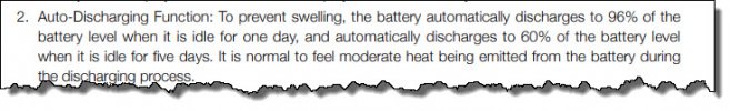

I have Dji air2s, this is regarding charging.for the storage of my batteries, I charge them to full charge, after that I run them down to 40% to 60 % by hovering etc. And repeat every couple of months .My question is what do I set the auto discharging rate to while storing? If I'am not mistaken the setting in the software is 0 to 9

Yeah, you're misinformed ...
You can't change the time for when the auto discharge starts for a DJI Mavic Air 2s in the DJI Fly app ... it's fixed according to below from page 27 in the user manual. So if you manually hover them down below 60% this has no relevance ...
