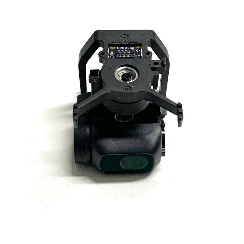

Mechanické poškození; Modul ramena gimbalu byl zlomený,
koaxiální kabel kardanu byl zlomený, flexibilní plochý kabel 3
v 1 byl zlomen, modul desky ESC byl zlomen, přední rameno
letadla (levé) bylo zlomené.
Translation (I didn't understand everything from czech language so): "Mechanical damage; Gimbal arm module was broken, coaxial cable of the gimbal was broken,
flexible flat cable 3 in 1 was broken, ESC board module was broken, front arm of the aircraft (left) was broken."
Gimbal Arm Module
€78.41
Coaxial Cable of the Gimbal
11.58€
Flexible Flat Cable 3 in 1
6.68€
ESC (Electronic Speed Controller) Board Module
https://www.aliexpress.com/item/1005003494255922.html (board with cable)
40.81€
Front Arm of the Aircraft (left front)
€9.16
