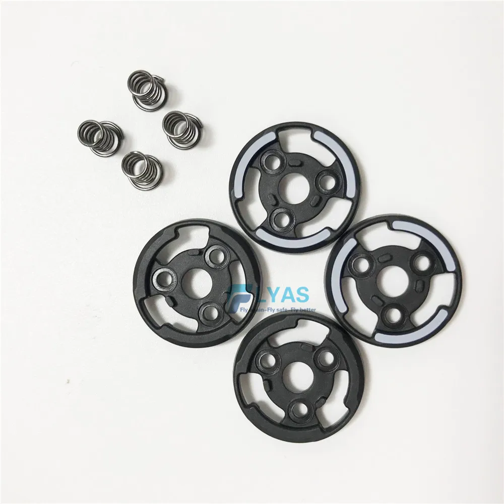

Mavic 2 Pro, right rear arm the prop lock is not holding the prop firmly on. Hit a tree and there is a small plastic part within that is not locking the prop in place. What is my best way & cost effective way to fix this?download.png
Mavic 2 Pro, right rear arm the prop lock is not holding the prop firmly on. Hit a tree and there is a small plastic part within that is not locking the prop in place. What is my best way & cost effective way to fix this?View attachment 138667

Without the picture, I'm not 100% certain what the issue is but I think it's safe to assume that you need a replacement propeller base plate. I found one on eBay, however, they ship from China which means you might be waiting over a month for them to arrive. However, you can also purchase a Mavic 2 Pro/Zoom replacement arm that has the prop base plate, remove it, and install it on your current drone. The main difference is that you can get 4 of the base plates for about $10 but one arm is around $20-30. I guess it just depends on how long you're willing to wait. You could also contact @DDS and ask if they have any by chance, however, I searched their parts website and don't see any for the Mavic 2 Pro/Zoom.
Base plates from China
Replacement arm
If the ring on top of the motor they are replaceable, have a look on ebay etc..
If it is a lug on the prop then scrap the prop.
If it is the spring that pushes the prop away from the motor then I have seen those on ebay but they may also come with the above ring.
If it is the shaft that goes through the prop then I would change the motor and that probably means changing the arm.
If it is the ring (BSauce's base plate?) do not lose any of the screws, if I remember correctly they are shouldered.
If you go for a motor or an arm and motor verify whether or not the ring and spring etc. are included, I bought a new arm and motor that was shown completer but which arrived missing the ring, the spring and the screws. The seller had, then, to send them separately.

Are you still able to fly without the prop falling off? If yes, it might not be too much of an issue, but I'd still want to replace it. From the picture, I'm seeing that yes, you'll need a replacement base plate. As I said in my second post (post #3) you essentially have two options for how to fix the issue. I'm not sure if @DDS has one, but you can contact them and ask.
