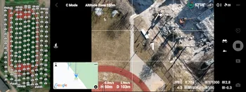

I tried a manual flight to capture map images on a small scale. Processed in Pix4D Cloud (Skyward.io)
Camera Model Name(s) L2D-20c_24.0mmf/2.8_12.3_5272x3948 (RGB)
Average Ground Sampling Distance (GSD) 0.75 cm / 0.30 in
Area Covered 0.010 km2 / 0.9562 ha / 0.00 sq. mi. / 2.3641 acres
View attachment 144381 View attachment 144382
That's actually pretty good. You manually triggered while on the move or stopped & shot?
How do you feel the detail was... or compared?
Is that a sectional concrete pour on a prepped sand surface?
The use of the M3 Cine SSD probably helps with speed of capture too! ;)

Can't get real close on the uploaded clips... but further examination, the pylons, tire tracks & metal grid actually look very sharp & clear even for small uploaded pics. That's actually encouraging & impressive!
I am not coordinated enough to shoot while moving in a straight line! I stopped with each saw-cut square centered, and this map includes oblique photos all around. I may process again because the obliques didn’t match up well.
The Pix4D Cloud is a new feature on Skyward and still missing a few features, like sharing..,
