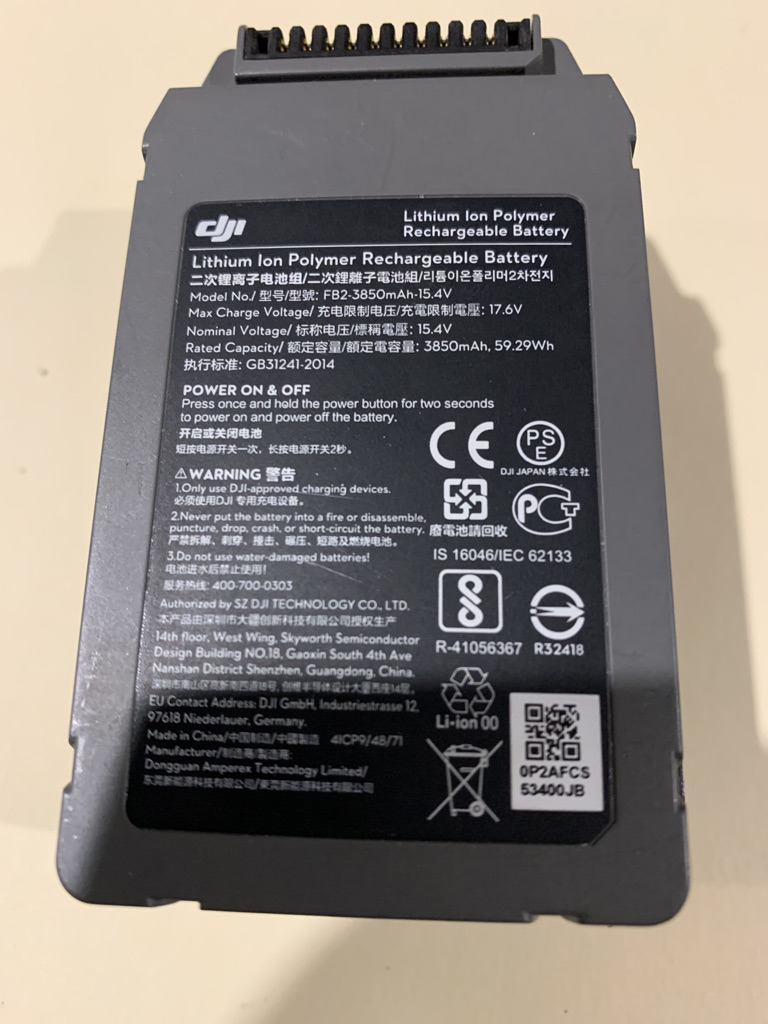

Up Date;
After resetting the new drone for flying, I put 1 of the 4 batteries, that I had, in and flew for 15 minutes then landed. I then saw that the battery had dislodged itself and was not clipped in, so I investigated what had happened and I found that the base of the battery was swollen. I could push it in with my fingers so I think I now know what happened to my first drone. When the battery got hot the plastic cover expanded putting pressure on the base and forcing it to dislodge from the aircraft.
Investigating further, I found that, by placing the batteries on a flat surface, the base of two of the batteries were swollen and I could rock the batteries back and forth side ways.
However by applying pressure with my fingers on the plastic covering I found there was a gap indicating that it’s not the battery that is swollen, it's the thin plastic covering that holds the battery in. So to overcome this I now use a zip tie, thin enough to leave it on and by slipping it to the back allow the battery to be replaced and not interfer with the folding arms.
The batteries dated 2019, charges = 32 each & indicating all in good order.
So what I want to know; are the batteries on their way out and is it safe to use them by securing them this way or should I replace them?
I have flown for ½ an hour with no problems.
I think DJI should investigate their batteries because there is a problem with the casing.
I would like to hear from anyone that has had the same problem.

...saw that the battery had dislodged itself and was not clipped in...
...found that the base of the battery was swollen
This is a well known & documented phenomenon with LiPo batteries ... as the chemistry breaks down inside the battery gassing can occur that will make the battery cells inside the plastic casing swell. Particular M2's have been over-represented when it comes to sudden power loss due to this ... either due to being pressed out so they disconnects or even dislodges completely from the craft. Many M2 owners use velcro straps to secure the battery to be able to limp back home if swelling suddenly occurs during flight.
...it’s not the battery that is swollen, it's the thin plastic covering that holds the battery
...are the batteries on their way out and is it safe to use them by securing them this way or should I replace them?
Yes it is ... it's gases inside the battery cells that make them swell. When this happens it's time to take them off flight duty & dispose of them properly ... with this amount of gassing they have started to be very prone for disaster both during use & charging.
Yes the same happen to me I posted last month the battery popped out and it crashed it was just out of warranty sent it to DJI and for $650 DJI replaced it with a new one they are now replacing 2 batteries that has swollen at no cost they only had 32 charges (I hope they will be here tomorrow). I will not trust the batteries again to prevent it happening again I have put a plastic zip tire around the body by sliding the tire to the back you can remove and replace the battery and it does not interfere with the folding up of the arms
