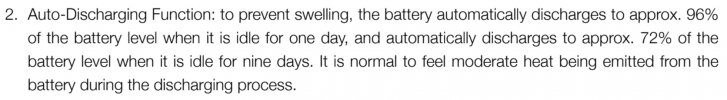

So I got the fly more with the multiple battery charger but I know LiPos need maintenance. So when I charge both and only use one, what do I do? What do you do?
Below is from page 21 in the user manual...
But if you often have this problem with returning with fully charged batteries, the auto discharge function isn't the best for your battery... a battery should as quickly as possible return to storage voltage level (at least within 48h), meaning be placed on 3,8v/cell. That correlates to 50% charged, but anywhere between 30-60% is good enough. So as you see...the auto discharge both take too long & places the battery on a too high charge level.
If too high, hover it down... too low, charge it & take it off the charger between one solid LED + one blinking up to two solid LED's + one blinking.

Or, just let DJI's Auto-Discharge Function do its thing. That's what most of us do. These batteries are items of consumption, and should be good for 200+ full cycles. Every time you charge them up and then bleed them down to 50% without using them to fly is using up an extra half cycle. So fly with them instead of bleeding them down! That's what they are for! You have 9 days to do so!
