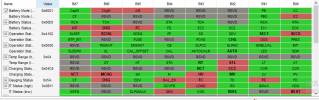

D电池容量10000毫安.可以安全飞行22公里外安全返航落地,你说的外加XT60需要改电池BQ9003内部参数的,不该参数飞机会按你预定容量计算飞行时间.IMG_3372.JPG

D battery capacity of 10,000 mAh. You can safely fly 22 kilometers away and return to the landing safely. If you add XT60, you need to change the internal parameters of the battery BQ9003. If you don't have the parameters, the aircraft will calculate the flight time according to your scheduled capacity.View attachment 173101

这两个电池重达680克。如果你有这个技能,你可以自己做一个并测试它。电池寿命仍然很好。使用8个ATL电池并填充6000MAH的容量。IT软件中的循环计数必须改为两次,否则将引发非正式电池
These two batteries weigh 680 grams. If you have this skill, you can make one yourself and test it. The battery life is still very good. USE 8 ATL BATTERIES AND FILL 6000MAH CAPACITY. The cycle count in IT software must be changed twice, otherwise it will trigger an informal battery.

The internal batteries are connected in series, and the external batteries are also connected in series. Finally, each internal balancing point is connected to the external battery balancing point. The premise is that the internal resistance capacity of the 8 cells must be consistent to ensure that there is no voltage difference. I will upload the video when I have time.
