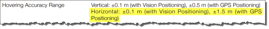

Considering that you stood & hovered close (within the reach of the VPS sensors) to rapid flowing water ... this is perfectly normal.
As seen here below from the manual the most accurate hover horizontal wise is when ground below the drone is within the reach of the VPS sensor (closer than 30m), which you were.
1627031832273.png And if that ground is moving it will trick the sensor & the horizontal hold will be erratic ...
View attachment 132242 And if that ground is moving it will trick the sensor & the horizontal hold will be erratic ...

Adding in with some more facts from the log ...
@kangarootbot ... in your flight you had 2 instances where a hover would have been erratic regarding horizontal hold.
1. Where you nearly fell back to ATTI 2 times between 84 & 98sec ... as seen here below the sat lock momentarily dropped to 7 & by that the navhealth went to 1/5.
But this incident went by unnoticed as you where in a forward/ascending flight ... but if you had been in a hover there you certainly have had a horizontal drift worse than the drift you had later in the flight (at 147sec) because here you had no proper horizontal assistance from neither the GPS or the VPS (due to moving water).
The 2 nearly ATTI occasions happens here very close to the trees ...
2. The occasion at 147sec where you actually hovered, explained in post #2 & #4 ... there you had GPS support with 11 satellites & navhealth 4/5 but here the VPS had a hard time to assist due to the moving & reflective surface beneath. The drift around the hover location was within those +/- 1,5m stated in the manual where horizontal hold is made only by the GPS.
