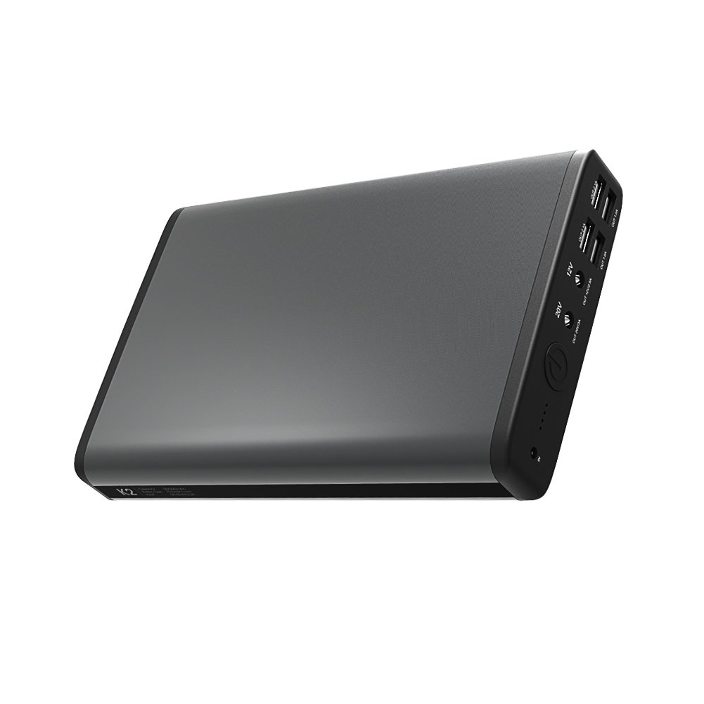

I've been using this from rav power 27000 mah a.c battery pack.
USB C Portable Charger, RAVPower 27000mAh Built in 220V AC Outlet Universal Power Bank Travel Charger (Type-C Port , Dual USB iSmart Ports , 19V/1.6A https://www.amazon.co.uk/dp/B01MDKHWNR?ref=yo_pop_ma_swf
