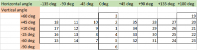

Does anyone know the specific camera angles the Mini3P uses when shooting a sphere panorama? It produces 35 stills that appear to be arranged in 8 columns, and 4 rows. 2 columns have an extra upwards looking shot, and one has an extra downward shot, approximately as follows. The numbers indicate the order in which the photos are taken:
What I'm not sure about are the vertical angle numbers, highlighted in orange. These are just a guess. Does anyone know what they should be?

Had a play, and found that by initiating a sphere pano and then cancelling it part way through it doesn't reset the aircraft orientation or gimbal pitch. Gimbal pitch can then be checked by nudging the gimbal up or down so that the pitch indicator appears. By stopping it after each of the first 6 photos I was able to positively confirm the following angles:
