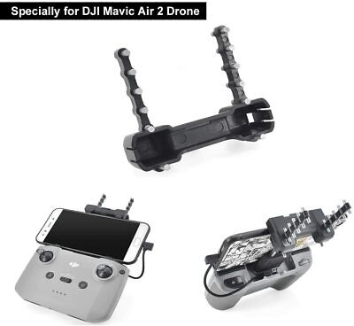

Might be cheaper to try the passive yagi antenna first

Any luck trying this on the MA2? I'm curious how much improvement there is..
