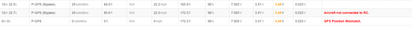

I had one just fall out the sky a few weeks back. No on screen warning, no collision or error on my behalf. Just logs like 'OSD.isMotorOn' - false.' suggesting the motors simply died within a 20mtr flight distance & it hit the deck from 85ft. Off it went to DJI & after trying to throw the cost book at me, I said 'we'll go through the DAT ourselves & here's the Phantom flight log. They did a quick back track & new Mini 3 Pro is on its way. It's the 4th I know of, so there are possibly a lot more. Always keep your incident DAT file. It saves a lot of arguing backward & forward when they try to suggest it's not a manufacturing fault & down to you ;)

Was it a Mini 3 Pro? I"m not sure what parameters are recorded, but was there any indication of overheating in the log or dat file?
