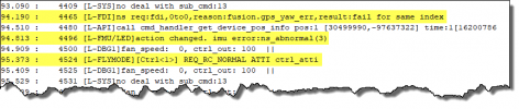

The DAT log event stream indicate that the reason for the ATTI mode was a IMU error.

The eventLog stream also shows several entries like this one.
33.409 : 1425 [L-DBG1]fan_speed: 0, ctrl_out: 100 ||
I looked at some other Spark .DATs which all showed fan speed > 0. E..g
11.763 : 375 [L-DBG1]fan_speed: 244, ctrl_out: 100 ||
I'm guessing that the fan wasn't connected. Maybe the cpu over heated causing FC errors.
Reactions: DDS and slup
