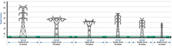

Is it possible to see power lines on a OA camera? Does it also give you a warning, or are the power lines to small for that? I live in Belgium and I do think our power lines are higher here, I just mention this because flying over them would take me above our 100 meter limit. So we are kinda forced to fly beneath them.
Not sure if you can see them, but I didn't get any warning, because I think they are too small for the OA to detect them.
Reactions: MikeB1970
Wow, you have power lines which are 100 meters high? That's high; really high. Yeah, I wouldn't want to fly anywhere near them. In my area, if I'm 100 meters up, there's absolutely nothing up there but the birds. I could literally close my eyes....metaphorically.
