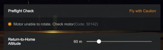

Just now I decided to power up the drone and see what it would do with the motor that felt stuck.
I started the motors manually and surely enough only 3 started spinning with the front left one refusing to budge. On DJI Fly I got the following message:
However, when I tried starting the motors again right after that message all props started immediately and no errors came up.
Tried 3 more times and started up fine every single time.
