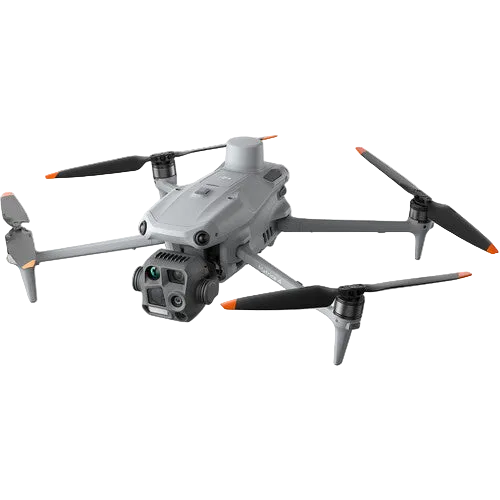

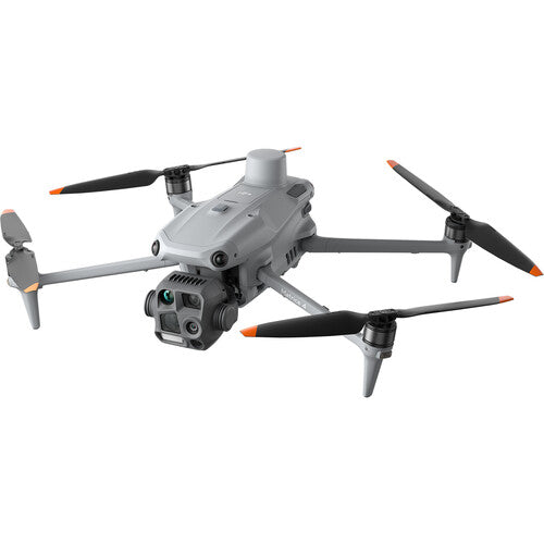

Matrice 4T is best DJI drone for this type of work.
Great complement to the Mavic 4 Pro!
Can the M-4T take regular photos or only Thermal?
It has some impressive features for sure. I just do not need to track down miscreants. DJI's implementation of thermal software and options for the use of the thermal data is very limiting. For doing what you mentioned, it is great. Using it for research is a disappointment. It is a very tightly controlled and expensive sandbox. Then there is the general shift away from DJI products in mining. Having units that are not DJI is kind of a plus of geotechnical work. The IR work I do is not thermal, I work just above that range. I had a project that could use thermal, but it was a bust, again due to DJI's software.
Which IR camera do you use?
The thermal drones can do visible light photos as well. You can set it up so it does both simultaneously. Wheil they have RTK positioning, they didn't include the precise time codes required to make it able to do precise maps. Kind of upsets many buyers after the fact. They cannot use it for both due to this omission, which is on purpose. All the data is there, they just don't include it in the photos. One trick pony philosophy.
There is a difference between IR photo and Thermal photo. Thermal is in the IR range of heat. While regular IR is just below the visible range and up to the thermal range. For geology as an example, carbonate rocks reflect IR light quite strongly. I use a small camera that does three bands, from MAPIR. I also have modified Nikon D800's that do IR and a Nikon V3 that does both UV and IR.
