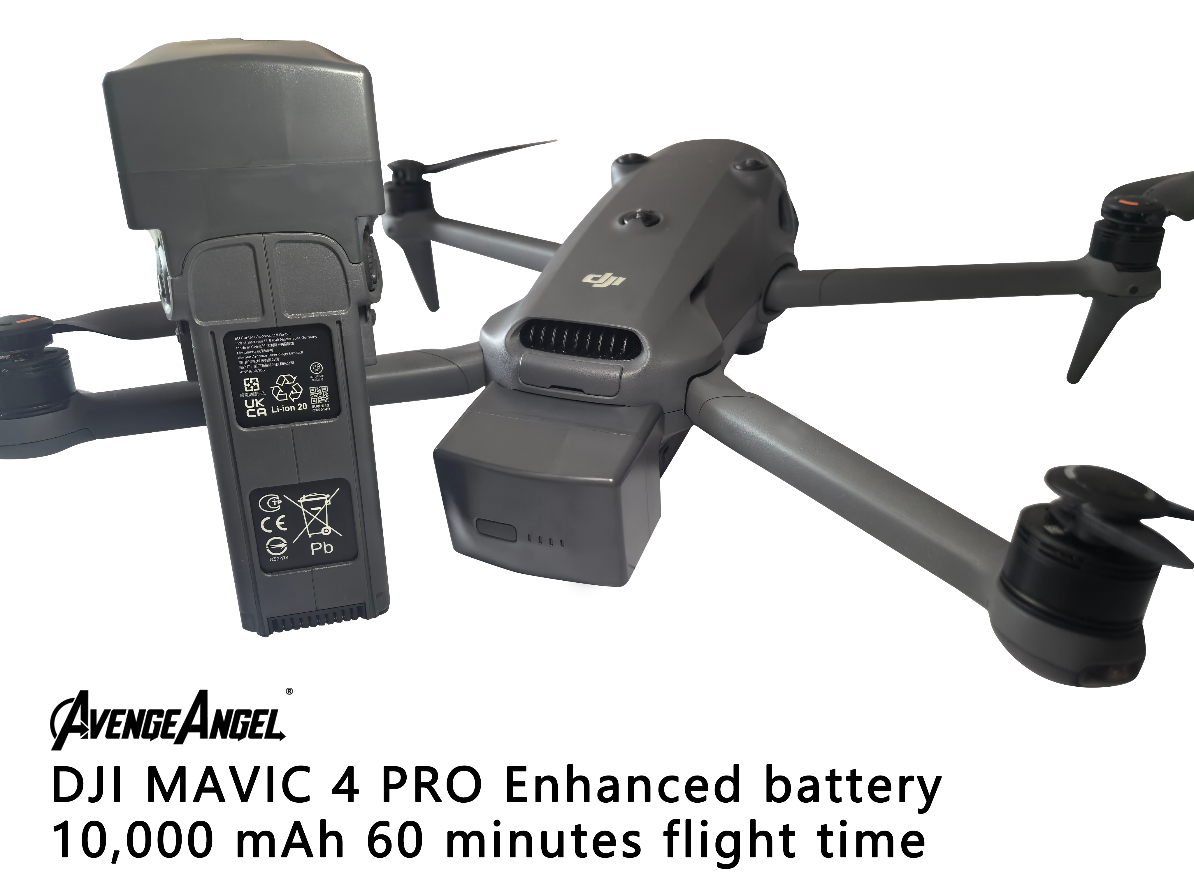

These guys make one. I mean it's only 10 more minutes but that's something. They make piggy back batteries for the Mavic 3 though.
Your welcome 😁

Hahaha.
What an eyesore!!
All that extra booty, for 10 more mins LOL.
You'd think you'd get at least 80-90mins with that...especially at that price.
Not sure what effect this would have to the motors either, running for a solid 60mins without stopping, let alone with a battery (if they make one) that could give you a continuous 80-90mins.

It appears to be 25% more in weight compared to the original battery (~339 grams). So that's only 83 grams. Well within the payload capacity. If it ads 10 extra minutes to the maximum flight time that's about 20% and add a bit more for the plastic and stuff. I mean if you want to fly for an hour with enhanced transmission that's an option. Perhaps you would've come back with plenty of battery left and no stress as long as you thoroughly tested it first.
This is a regular battery with an extra 10 minutes. From DJI the battery is $240 & $300 USD depending where you bought it from. So about $48 per 10 minutes from DJI. So it costs a bit more than normal if you look at it that way. About $67 every 10 minutes.
