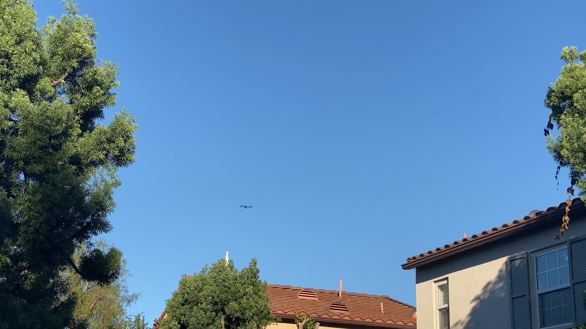

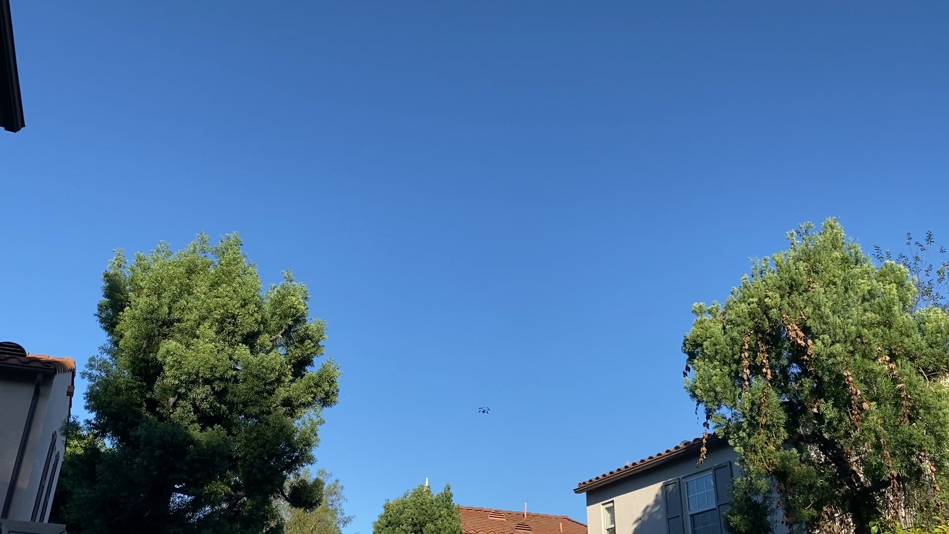

The drone is 3 days old, and it's exhibiting a weird, wavy, stop-start type of behavior when flying forward. Like it senses something, slams on the brakes, then starts going again.
I thought it was the sun hitting the sensors, so I tried flying at all different angles to the sun, and it happened in all of them.
This only happens in NORMAL mode; it will not happen in SPORT mode. I don't think the drone is going fast enough in CINEMATIC mode to trigger it.
Here's a video of it happening.
Here's a closer one:
Any ideas on how to get rid of this?
I just updated the drone and controller to the latest firmware today.
