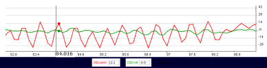

Looking at the first example, [82 - 89] secs, it can be seen that both pitch and, to a lesser extent, roll are oscillating at about 2.5 hZ. Further, there is a phase difference of about 90°.
1711979178627.pngThere are other events where the oscillations weren't as extreme as the ones you cited; e.g. [1213, 1216] secs. The cited events all occurred when flying into the wind while the Mini 4 was close to max pitch forward. It would be interesting to see if this happens flying backwards.
My advice is to contact DJI and return for either repair of replacement. You might want to first check the props; no nicks, no loose screws, etc.
View attachment 173997There are other events where the oscillations weren't as extreme as the ones you cited; e.g. [1213, 1216] secs. The cited events all occurred when flying into the wind while the Mini 4 was close to max pitch forward. It would be interesting to see if this happens flying backwards.
