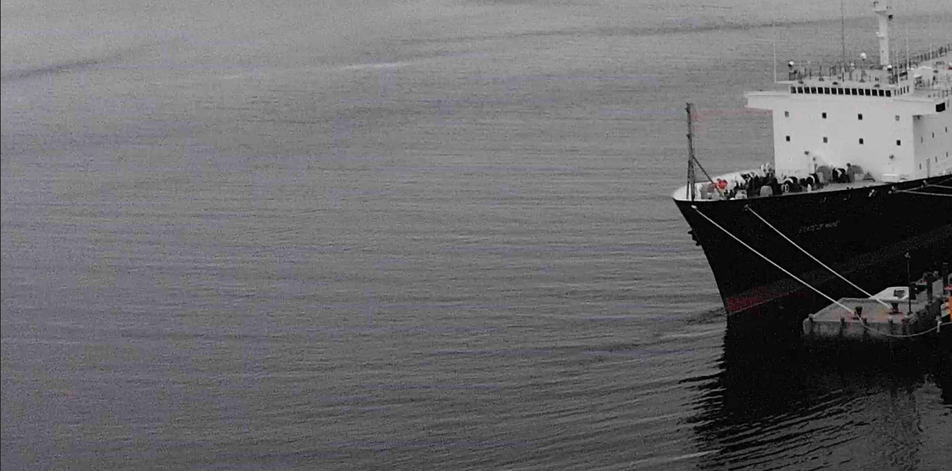

Here is another shot with exactly the same settings 1/60 30fps ISO 100 on U3 card.

I believe this is a combination of chromatic aberration
71346
and moiré caused by the ripples in the water.
71344
I used Adobe Camera Raw defringe tool to remove the purple aberration in the lens correction panel, used a selective brush tool and added a small amount of global grain to remove the moire.

WOW! Awesome! I really appreciate you taking the time to work on this for me. Here are two more photos where it is a lot more noticeable. The top one has colorista and bottom is no color correction.
As for the moire would that cause the pixel stuff to appear to be blocky? You can still see the pinkish color on the no correction shot just not as much. rear boat.PNGrear without color correction.PNG

Yea I don’t think I was right at all. I’m thinking this is just a really underexposed footage that when boosted is just stretching out the color range too much.
You don’t have any highlights or even midtones in there what so ever. So when you stretch out the histogram it stretches out the colors too so you’ll get color that wasn’t meant to be in certain tones appearing. Editing software can’t make something out of nothing.
So you’ll need to do a selective color adjust or a hue saturation curve to push that color back to where it’s suppose to be. Make it look better if you go for totally removing it you’ll drive yourself crazy.
Can you even tell it’s there when the video is played back?
It’s on your red channel btw. When boosting just the blue and green it’s not there. View attachment 71380
Interesting, I can definitely still see the blocky pink in the top corners in the blue and green photo. As for my playback without any color correction, you can see it as well just not as much. Definitely to the point I wouldn't show anyone and be proud of it. The sun is finally shining today so I am going to go out and experiment with this and I will let you know what I come up with. The underexposed tip makes a ton of sense because the first words out of my mouth when I got to the location was "**** its dark out here" Can't help but feel like having an ND8 might have also been too much. Maybe an ND4 for dark days like this?
