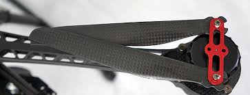

Hi Blue Bird, DJI have been producing much larger folding props with their Spreading Wings series Hexa and Octocopter platforms for a number of years now. These wee Mavic ones appear pretty good to me. And as others have noted, they are so cheap it would pay to swap out when you feel they have done their dash. As to when that is, well it comes down to how much work they have done, how they've been treated etc. I have six spare pairs already as to me they are a disposable/maintenance item.
can you send some pics of those? would love to see them and make comparison. Thanx..BB..
They're carbon fibre and 15". Different ball game compared to the Mavics.
images
Original Evo props from the S1000. I thought they only came fitted with the plastic ones, but found these.
images
Will these se fit the Mavic? If so, where do you purchase? Any advantage or disadvantage with these vs OEM?
