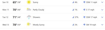

Going out to west Texas next week to shoot some video for a friend with my Air 3. What is the top wind speed you guys would feel safe flying in? I've heard the Air 3 is very good with winds. Attached is a jpg of the forecasted winds the 3 days I'll be out there. Thanks guys!

I came to California after Living in West Texas I don't miss the wind and the Dust You are getting pretty close with those wind speeds Not serious wind BUT You will burn thru the batteries faster Don't forget the Charger.

John, as a rule of thumb, I don't fly when winds are over 15 mph. However, I know the Air 3 can handle it, I just don't chance it. If you do, I would be very careful and keep the distance as short as possible.

You should be fine with winds <20 mph if you're careful. Be aware of the wind direction and try to make your flights upwind of your home point. Be mindful of the battery level and don't let the drone get so far downwind that you have difficulty returning. And be aware of locally higher windspeeds around objects like buildings and significant landforms.

My rule of thumb is if my gimble cant keep up its to much wind... Air3 is a beast and wind isnt going to take it down... Now just make sure you can get back with battery life and if your trying to fly in between things then that's a different game cause it can get blown around some and you don't want to clip a tree branch.

Just be aware that wind speed generally increases with altitude, so, if you encounter excessive winds, flying lower will inevitably reduce the wind speed. Those forecasted wind speeds are at ground level. Winds at 100 or 200 feet AGL will be faster! If your drone is losing headway into the wind, pop it into Sport mode and fly lower.

I can't give you advice on your Air 3, but I can tell you that these drones will handle more than you would think. I fly an I2 and a Mavic 3 . Just got back from an oilfield assignment in far West Texas and winds were anywhere from 20 to 55 mph, the Mavic 3 handled them all. Battery consumption decreases as the winds ramp up and you have to be cognizant of what the wind direction is when you are bringing it back to you, but I would think that you'll be good in the 20-25 range, probably wouldn't push it beyond that.
