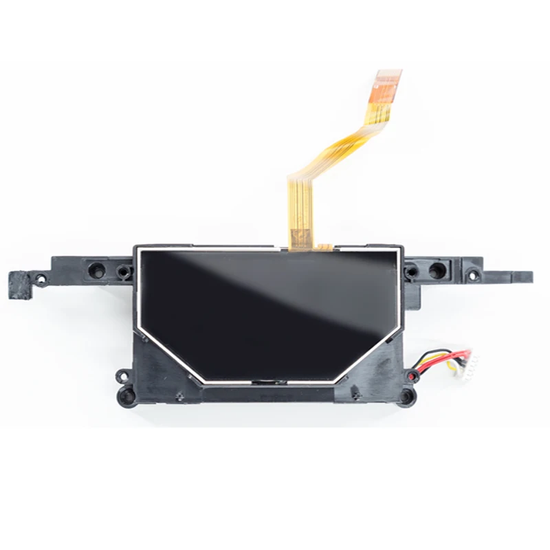

Good evening, quick question. Wondering if anybody knows if you can buy and replace the ribbon cables inside the mavic Pro Controller. Or if it's possible for myself or a really good electronics repair shop that hasn't let me down yet with drone repairs that I can't do on my own, to micro solder a slight tear in the orange ribbon cable inside the controller that goes to the top of the screen. It is still intact just a slight tear in the corner and now I'm getting no power. thank you very much in advance.

I don't think it's possible to repair that, the flex in it will cause it to break again. Best to replace the cable.
That is now Stuf.....d.
Only way to fix is new screen with ribbon.
The tracks are fused between 2 layers of celephane and any attempt to repair (heat etc) will only make it worse.
