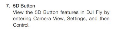

Hello everyone. With the latest update, the 5D button is now programmable, it seems. But never having used it before, I don’t know how to use it. Does anyone know? is there a video or a manual somewhere that explains it? Thanks.
I don't think there's a manual ... there are just 5 commands you can manually set to "press" - "left" - "right" - "up" - "down".
The left / right and up / down combination is commonly used for changes in a linear direction like ev +/-, aperture +/- (what was possible with the Mavic 2 Pro controller... unfortunately not yet? for the RC Pro), but you can assign those directions freely as well.
