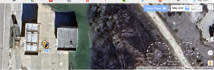

Thank you sir. I was looking for a review of the data and didn't want to potentially bias anyone with what I think happened. Essentially, one of our pilots crashed the Mini 3, and the explanation was somewhat cryptic as to what happened. The location where the pilot took off was at a gas station. The pilot launched between the gas pumps with an overhead awning and the building, next to his vehicle. He pulled up between the pumps and building, set the drone outside his vehicle, and took off. I attached the screen shot from AirData. That hopefully gives some context to the site.
I put the data into the Phantom site. I noticed that almost immediately after powering on the drone, the pilot launched with no GPS fix and without an established home point. The pilot look the drone up to about 14-15 feet, and then went backwards.
I think the pilot climbed to the 15 feet with the intent of clearing the awning over the gas pumps, stated to maneuver backwards to get to the subject property for the photos, but backed into the awning, around 15 feet high. The collision then caused the motor errors, and the drone fell end-over-end to the ground. I think the compass changes, etc that you're referring to are when the drone was falling to the ground. I think the motor errors happened when the rear motors (one or both) collided with (because he was going backwards) the awing (those motors stopped), the front ones kept spinning, and the drone flipped over end-over-end, and tumbled 15 feet to the ground.
That sounds like it could have been a reinforced concrete surface?
... which could be the source of the magnetic interference.
